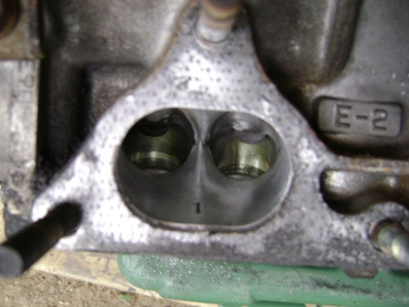

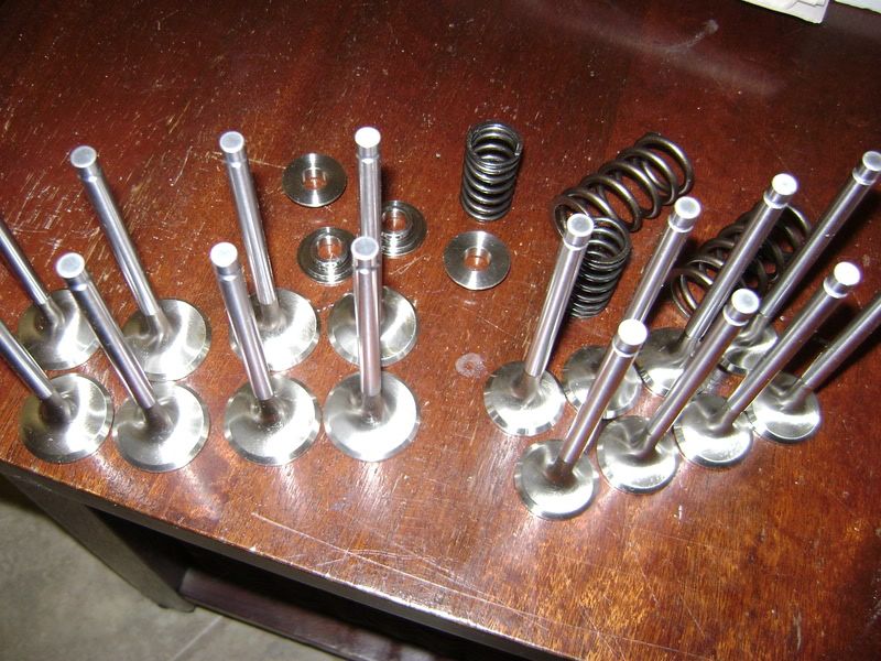

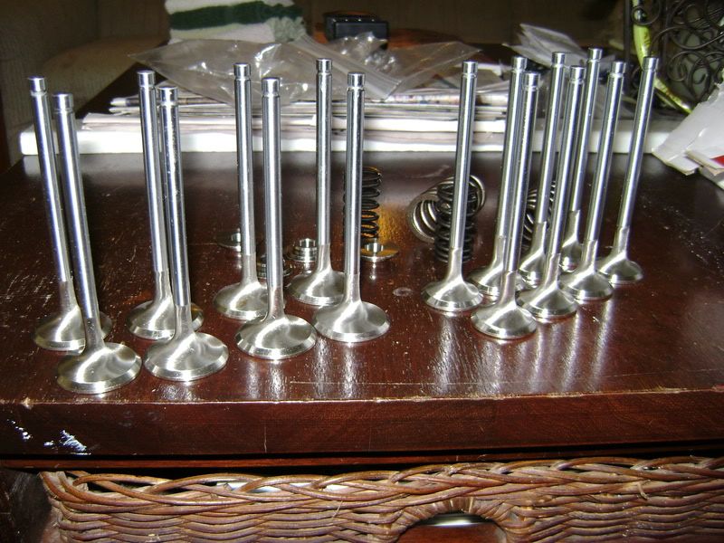

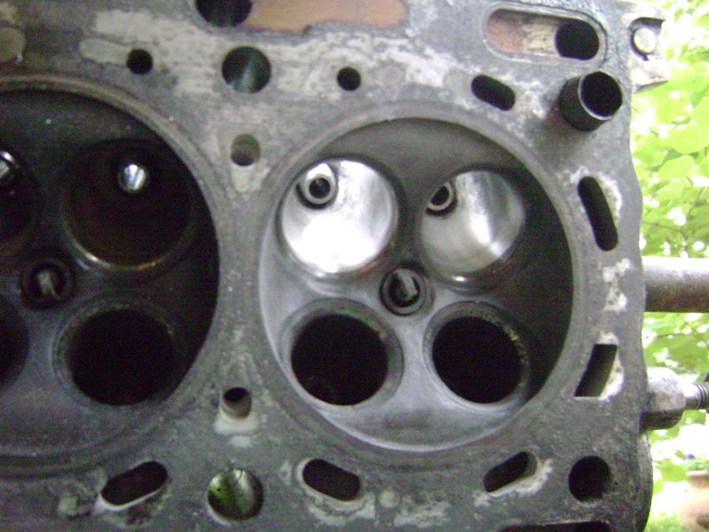

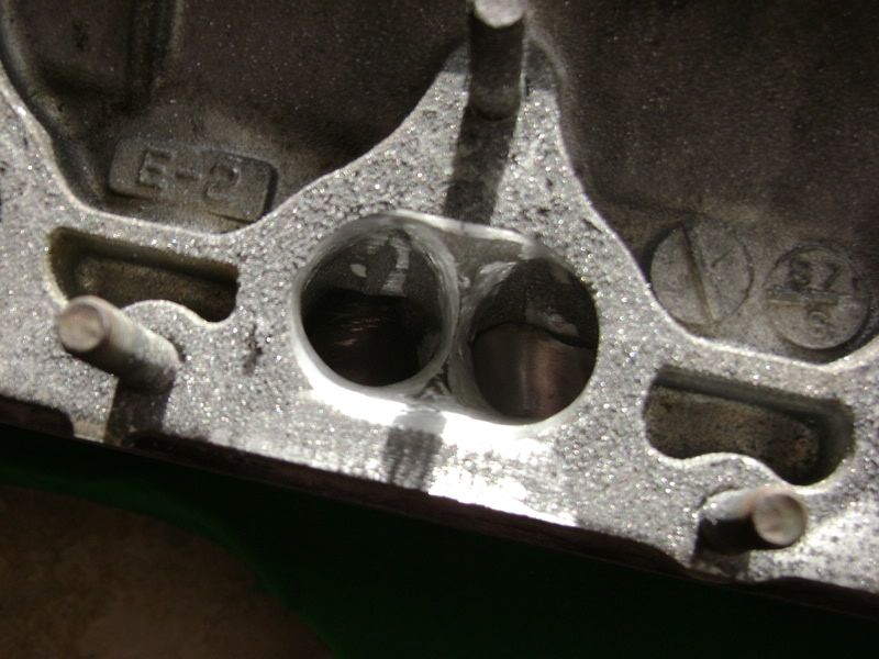

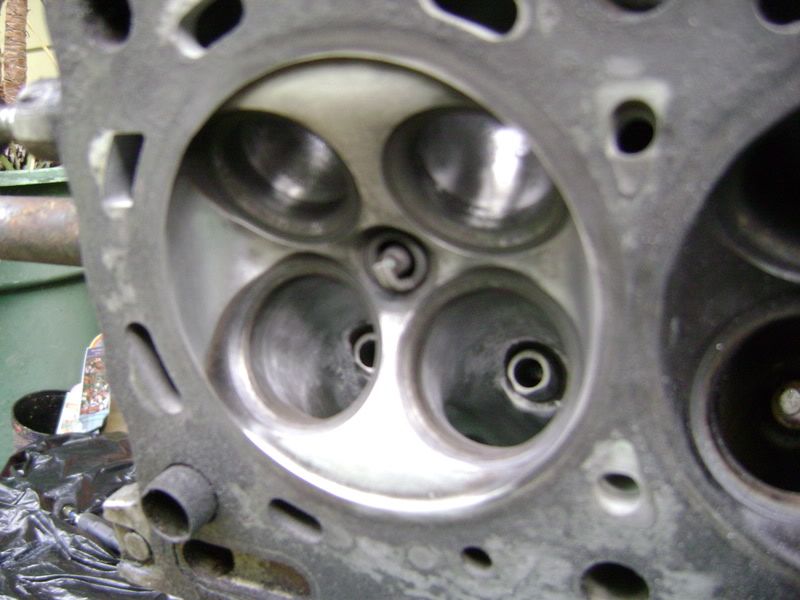

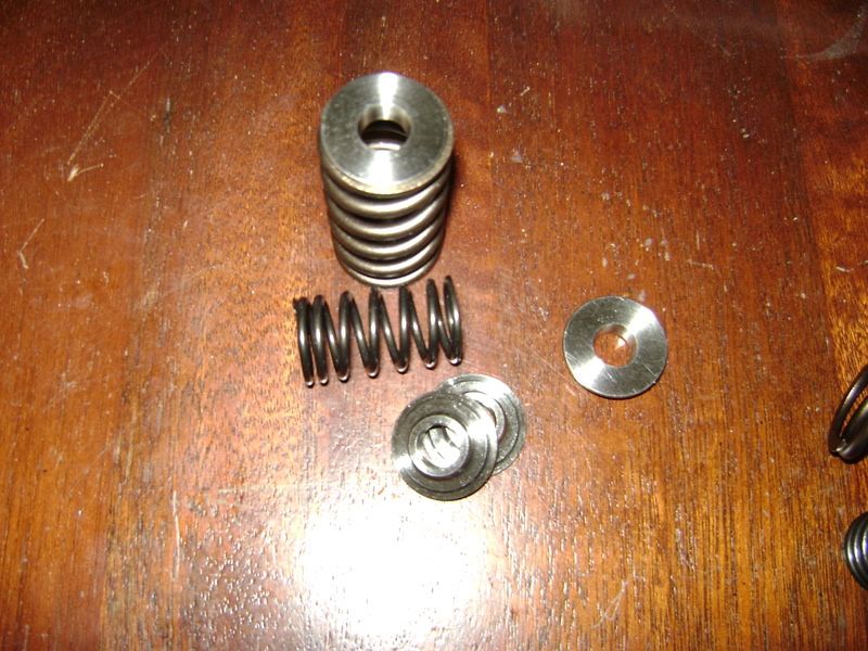

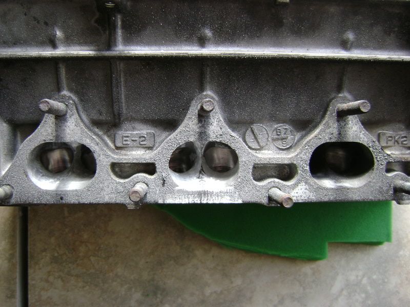

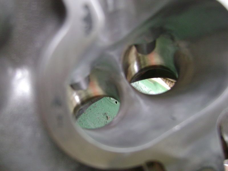

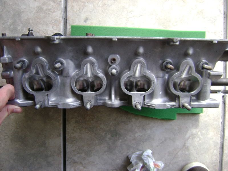

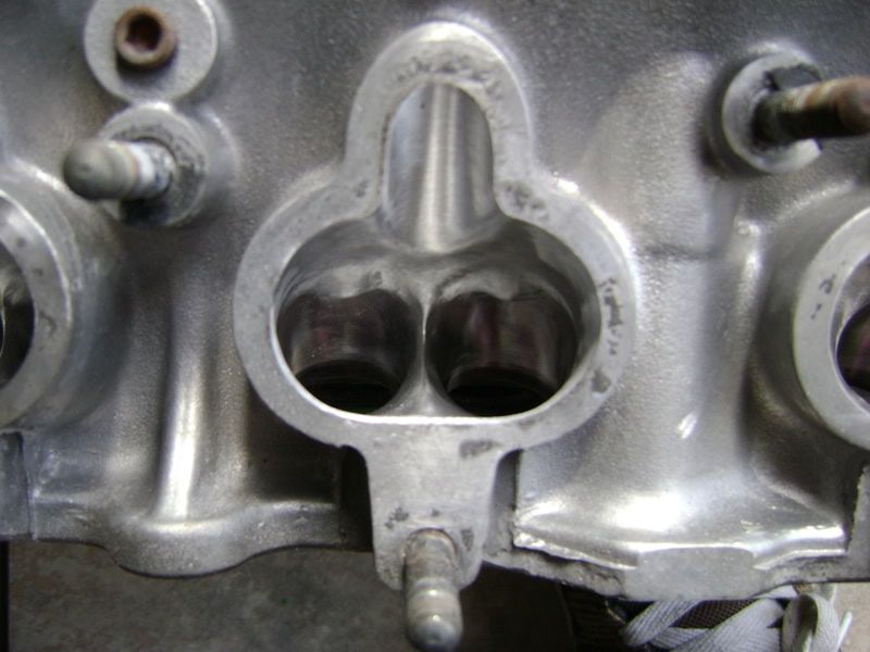

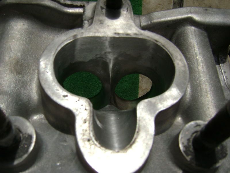

So its been a hectic time trying to get everything together and finding time to work on the lude. Its been quiet a while since Ive posted any info. But on a good note I FINALLY, FINALLY,......FINALLY received my valvetrain that I ordered back in June!!! Ive recently progressed a little on the cylinder heads port and polish. Within the next few weeks you guys will be seeing a lot more parts rolling in and some more progression on this car. Heres some pics of the valves, etc, and the work that Ive done on the head so far:
Exhaust-Just started

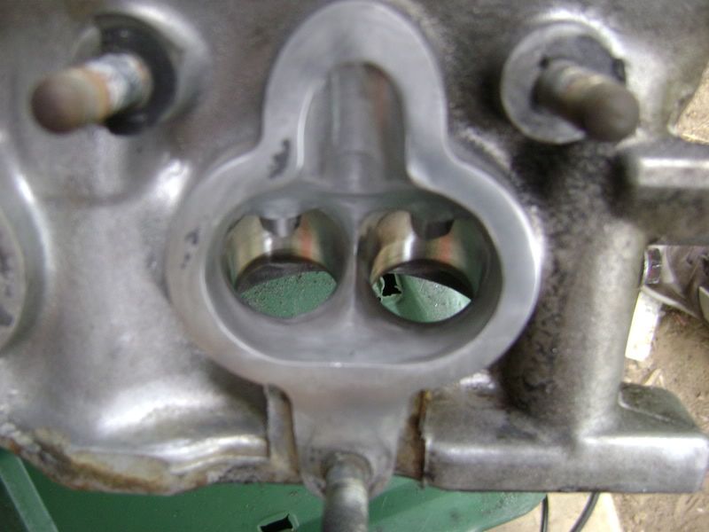

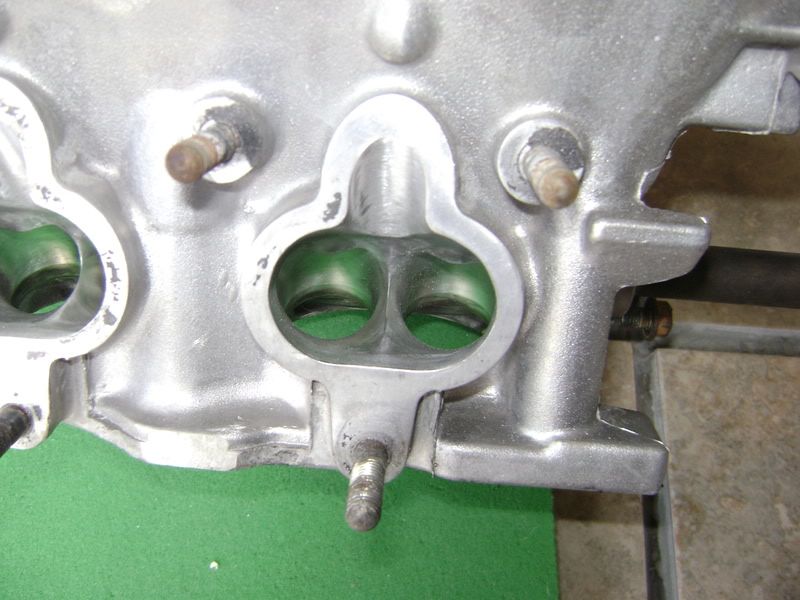

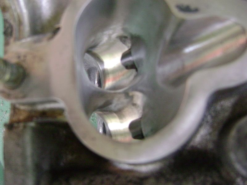

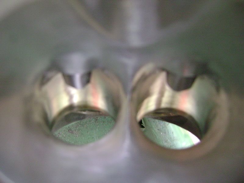

UPDATE: 6/30/08

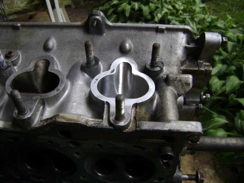

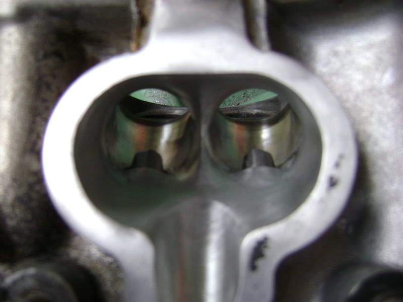

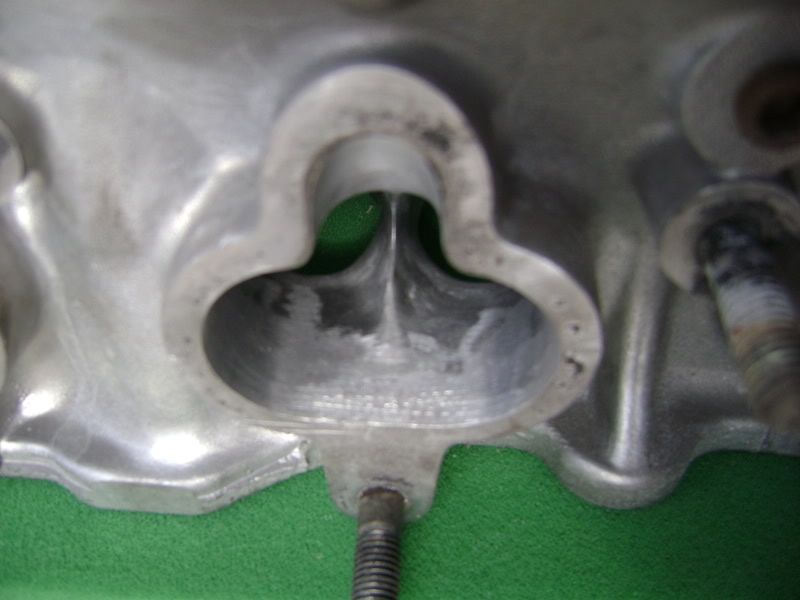

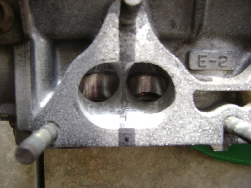

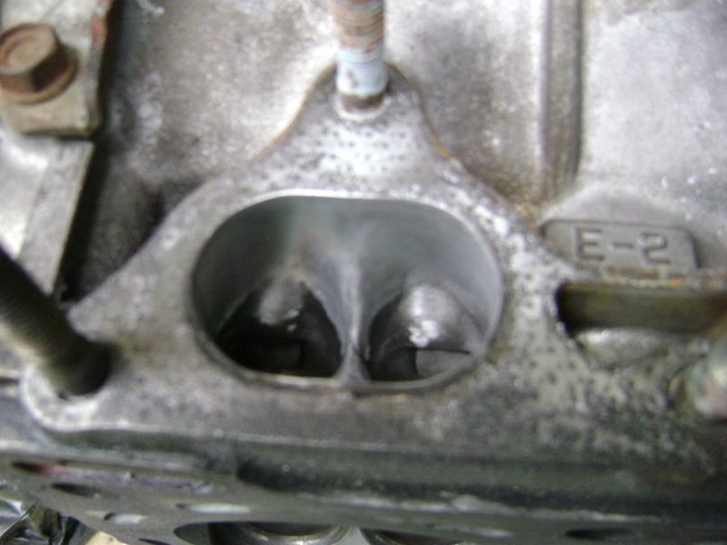

I had a small amount of time today, so I decided to start polishing and trying to finish one of the intake ports. I also started on the exhaust side of the head. This has been really time consuming....I really need to take a vacation so that I can get this head done!!! Keep in mind this is my FIRST time porting/polishing a cylinder head. Ive done a few intake manifolds and other machine work, but not a head. Its fun and a learning experience for me, but I think itll perform a little better than stock. So here are some pictures:
Started one of the exhaust ports.....

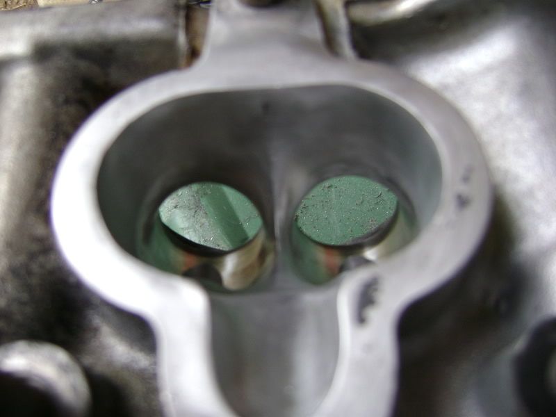

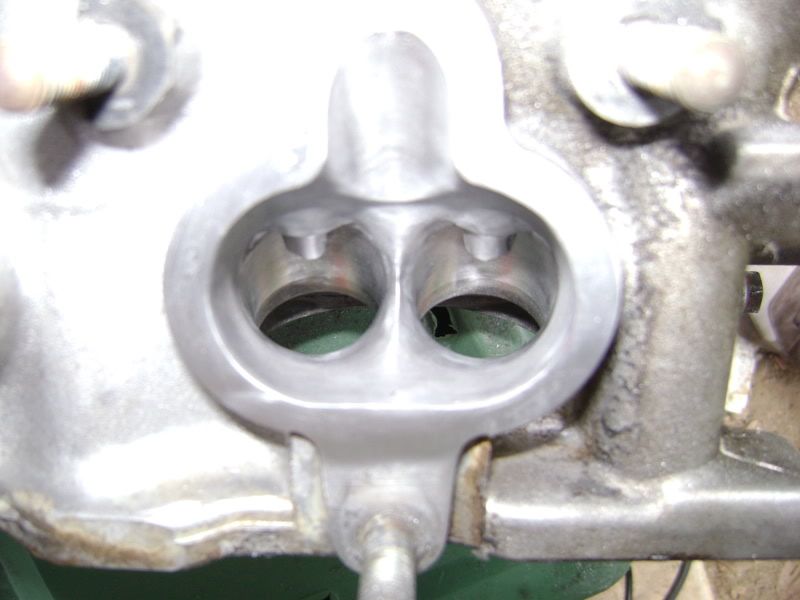

A few pics......

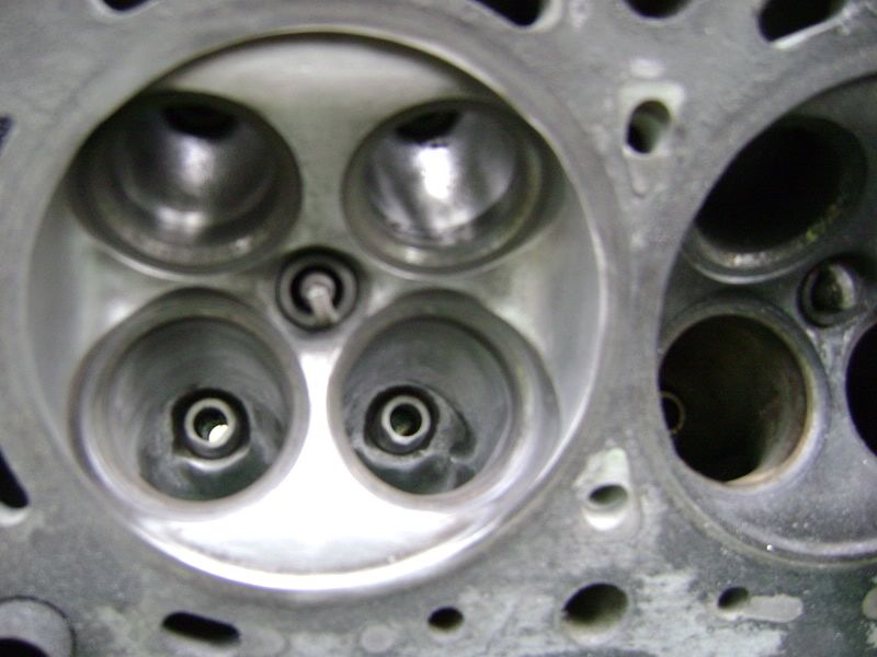

Here is the bottom end, which is in really good condition! Still have to remove the rods and pistons....

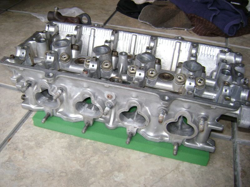

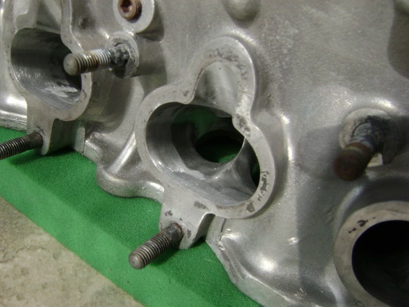

Heres the cylinder head. Ive started cleaning up the ports and port matching the intake side. Ive got a lot of work to do hear. All of the cast lines and rough-ness will be removed from IN/EX ports. Then all the ports will be polished. After the new valvetrain comes in itll be off to the machine shop to have the guides and valve seats worked.

I was very shocked when I saw the bearings... This engine came out of my 88 auto, which I bought from the original owner. It has 224,000mi....I have all the maintenance records and it never shows having been rebuilt. It didnt appear that anyone had taken any of the bottom end apart.
#16 ·
^x2 clean bottom end. nice port work
#21 ·
haha.....yeah I lucked up on it! Whats sad is that my b21s cylinders and internals were immaculate. The cylinders had a good bit of wear, but NO scarring, scratches, nothing! I couldve rebuilt it with Honda .025 over but I already had rings for the 83mm bore. Plus I couldnt find anyone to hone it....But thankfully this b20 looks really good inside and should work out for the build.

When you so called "Port and Polish" you want to leave the Intake Manifold with a semi-ruff surface. Theoretically you want the air and fuel to "tumble" so you get a better mixture. Exhaust you can port and polish the shit out of, that wont hurt. That's my .10 looks good thus far.

I have personally used Webcams and i would highly recommend them. I have heard nothing but bad things about Colt though. The head porting looks good but are you doing this yourself? I would personally give it to someone with 10+ years experience to do my porting so you know it will be done right and make better flow numbers than doing it yourself. You could make things worse. Are you tapering your valves? Getting bigger valves? Port matching the intake manifold? Id recommend you shave a little off that head too cause it looks like crap. I would say O-ring the head while you have it out too just for safe measure. Good luck with your build. I have something special being built at the moment too. But my stuff is a bit "different".
#34 · (Edited)
Yes head porting is being done by me. Im pretty confident that Im doing NO harm to this head. New valve seats, new valves,springs, retainers, and seals will be put in. They are stock size valves. Who doesnt resurface a head when you have a head off of a motor?? haha! The red markings on the head ports would indicate that Im port-matching to the manifolds. Thanks for the good luck, haha...Im gona need it!! I just have NO time to work on it, and it sucks.

well....not so good. The valve train that I got from JGE was defective. All the springs leaned over when stood up on either end, and the valves were ground crooked. I put the end of the valve stems in a drill and spun all of them, to find out that the heads of the valves wobble. I sent them back and they should be sending me a new set. They made 5 more kits since I purchased mine thank god!!
